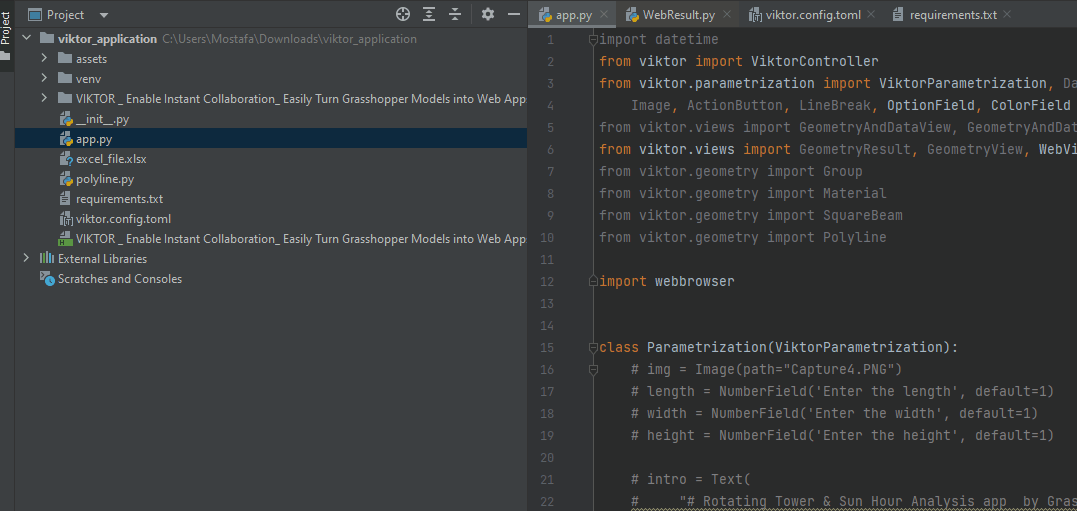

Usually, when creating scripts, you install Python packages that aren't part of the standard library using pip, the Python package manager, before you can use them. When developing or publishing VIKTOR apps, we handle this process for you. Simply include the required packages in a file called requirements.txt. Other dependencies can be included in viktor.config.toml, located in your app folder. This way, we ensure that you can use these packages in your app after publishing your app. The difference is outlined below:
1. Standard Python packages
If a package is not a part of the Python standard library, you can include it in your requirements.txt file within your integrated development environment (IDE). For instance, you can insert packages, like NumPy, here to make sure that they are installed with your app.
2. System dependencies for external packages
Some Python packages require additional software to be installed before you can use them. During local app development, you can install the necessary software on your machine. However, when your app is published, the additional software also needs to be installed on the VIKTOR cloud to ensure the published app functions correctly. By defining the necessary packages in the viktor.config.toml file, you ensure your app gets all the required external installations on the cloud. This way, the app can function properly once it is published on the VIKTOR platform. This unified approach ensures that your app and its additional dependencies are hosted together on the VIKTOR platform.
