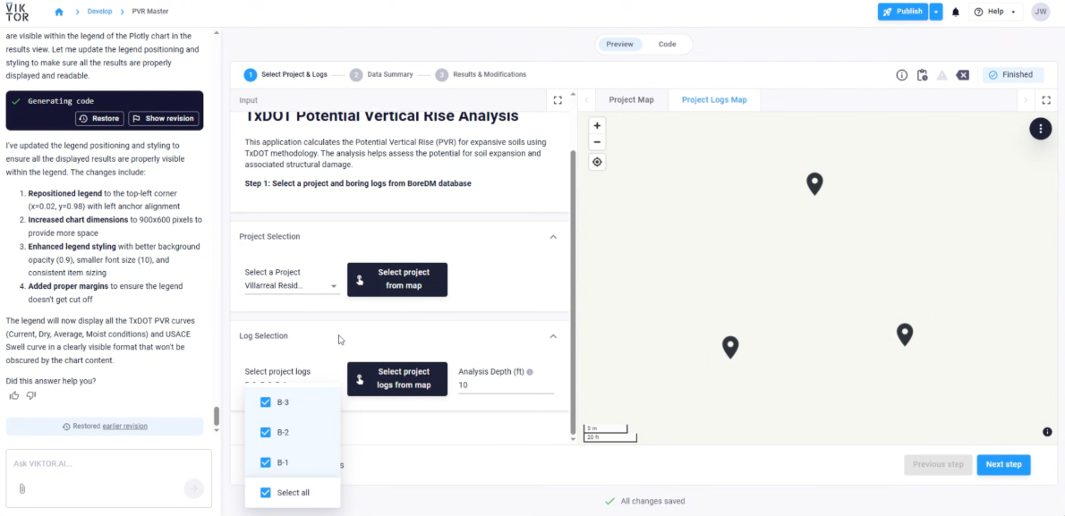

Creating the application in the VIKTOR App Builder

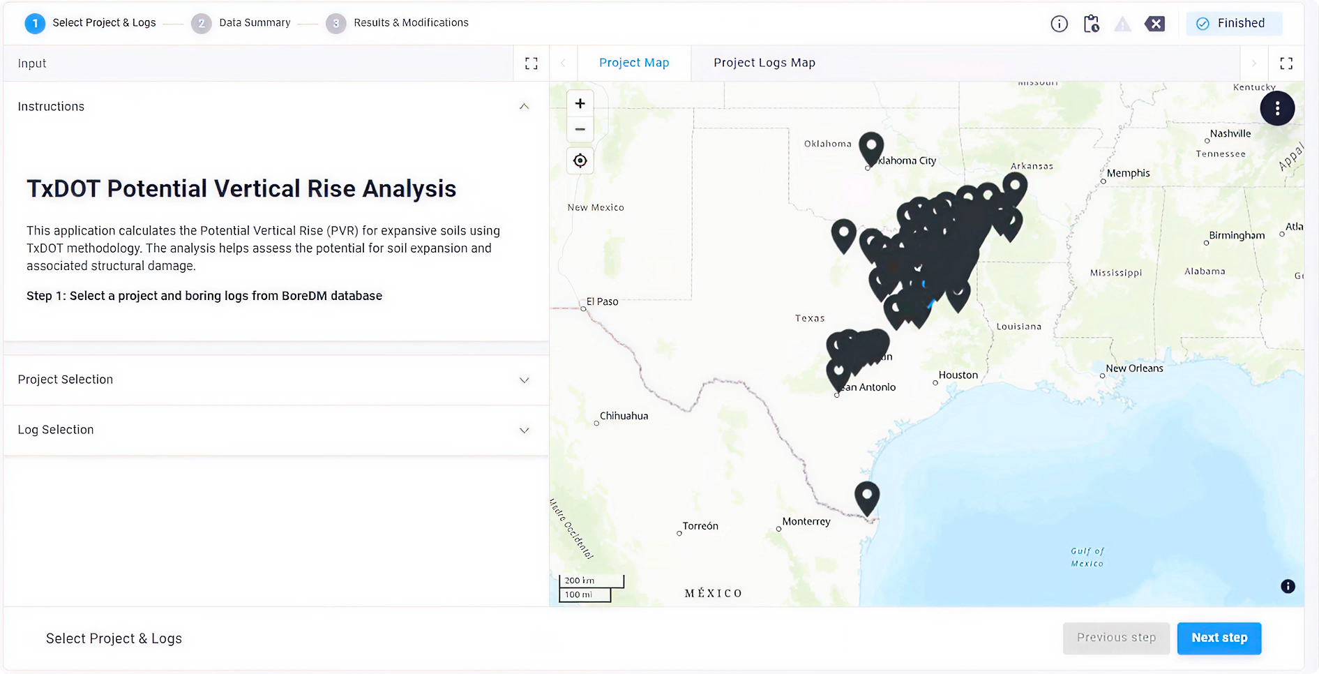

  • Select BoreDM project inside the VIKTOR app.
  • Borings appear automatically.
  • Set active moisture zone with a single click.
  • Dual PVR methods run instantly and results feed back into BoreDM.

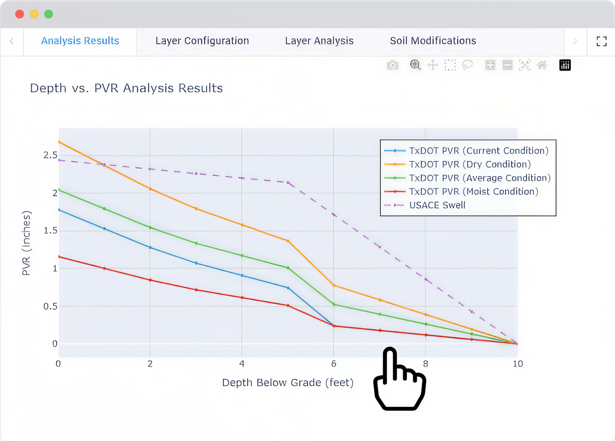

A graph of the Depth vs. Analysis results from the application
